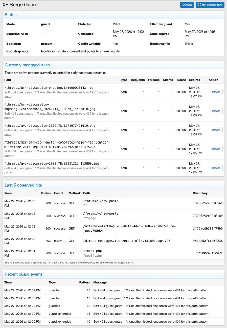

Admin dashboard
XF Surge Guard includes a practical Admin CP dashboard showing:
- Current mode
- Whether the state file is valid
- Whether effective early guarding is active
- Number of exported rules
- Bootstrap status
- Config writability
- Currently managed rules
- Why each rule was managed
- Request count, failure count, client count, score, and expiry time
- Manual release controls for managed rules
- Recent observed hits
- Recent guard events
It shows what is being managed, why it was managed, when it expires, and whether the early bootstrap guard is healthy.
Managed rules are temporary path patterns exported for early bootstrap protection.Each rule includes:
- The managed path
- The reason it qualified
- Request and failure counts
- Approximate client count
- Score
- Expiry time
- A manual release action
They are short-lived protection entries designed to reduce repeated or high-confidence guest request waste during the period where that pattern is useful to guard.
Recent observed hits and guard events
XF Surge Guard keeps bounded local diagnostic logs for recent observed hits and recent guard events.These are not intended to be a full traffic analytics system.
They are there so you can confirm what the add-on is seeing, what it is managing, and whether Guard mode is behaving as expected.
Early-blocked requests are intentionally not logged per-hit by XenForo, because the point is to avoid booting XenForo for those requests.
