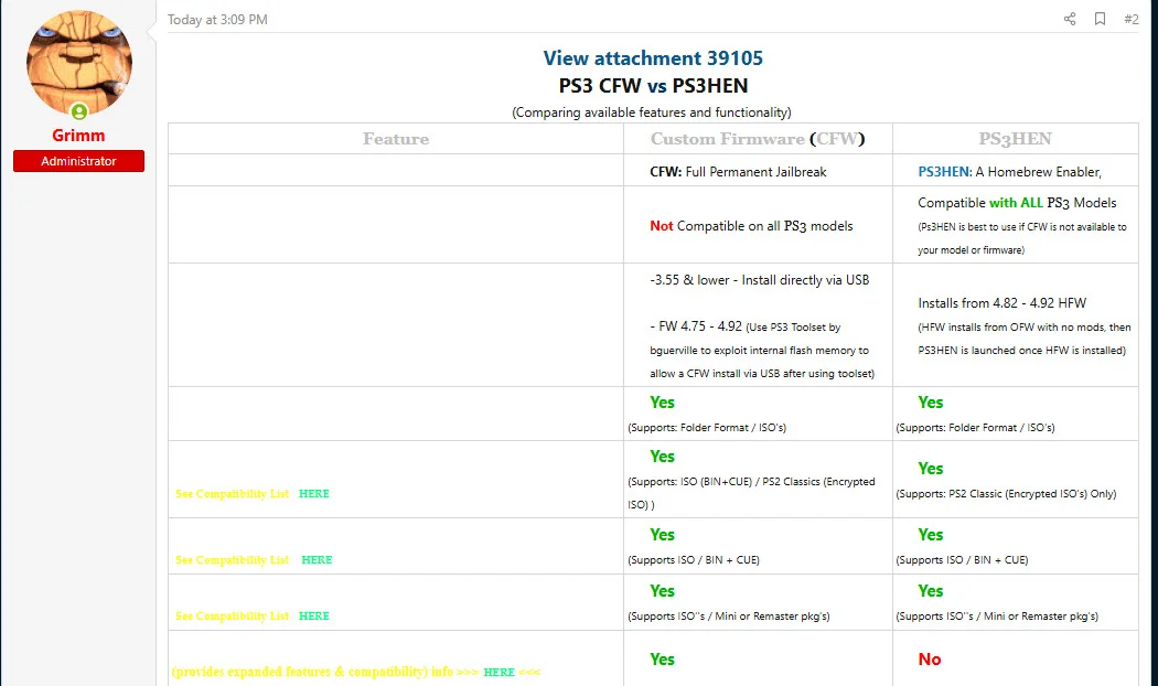

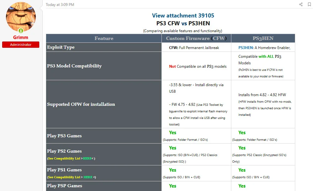

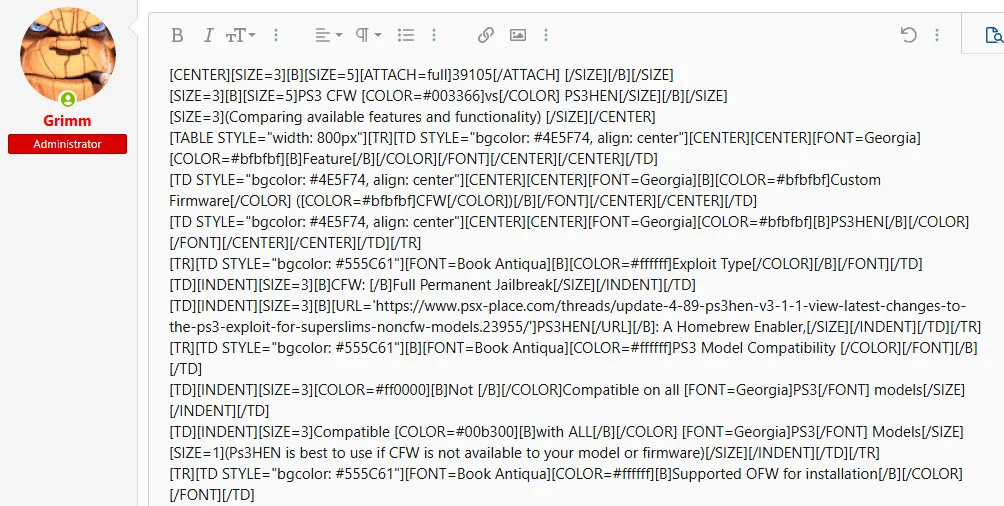

The screenshots show some sample bbcode, then a rendered table (which only renders at all because of the SQL changes) without the plugin enabled, and finally the same post with the plugin enabled.
Code:
[TABLE="width:800px,text-align:center"]
[TR="bgcolor=grey"]
[TD="text-align:left,font-weight:bold"]
... etc ... etc
