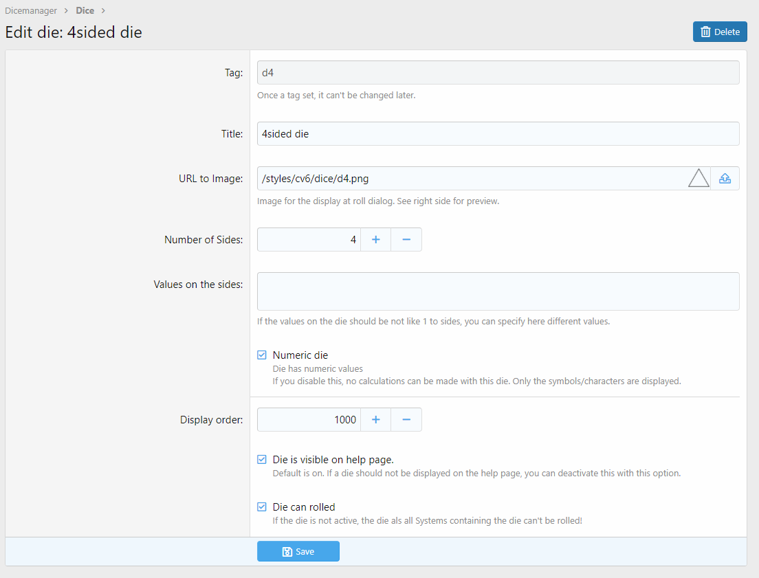

3. Create at least one die
In the Asset Upload field, will appear a small preview.
Tag: The tag is fixed, like it is for custom fields also. But its not shown to the public.
Title: This will be displayed at several ponts.
URL to image: If you want to display the die with a special Background image. otherwise a default fallback will be used.
Values: If you don't wat to have a default die, you can specify the values on the sides. The values can be comma seperated, and the system understands ranges like: 1-3. If the entered values are less than sides, they will be taken multiple times. For Instance if you create a 10 sided die, and you are entering only 5 values, all will be twice on the die. But, this makes no sense. In this case you can just build a 5-sided die.
Numeric die: Tick this box, if the values on the die are numeric. Only Numeric dice can build sums, can crit and can explode.
Display order: Yea, you know this.
Help Page: If you tick this option, this die is visible on the help page. You can use this, if you have too many die, to keep the help page short and clean.
Die can rolled: If this die is probably replaced by another, but should remain active, tick this. If a die is rolled in the past, and you don't want to use it anymore, but it was used before, use this option to deactivate the die. If you delete it, all old rolls may run into trouble.

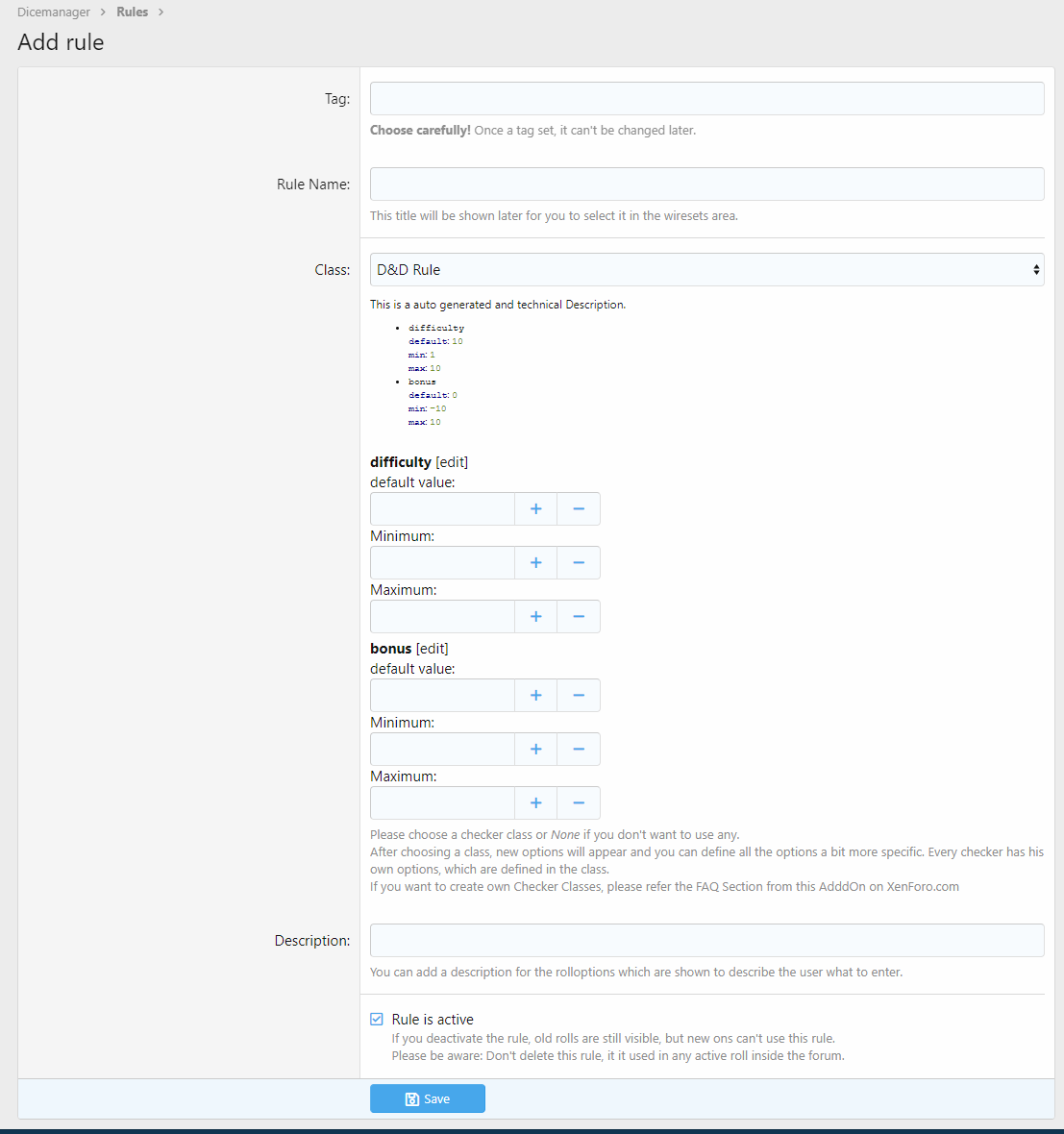

4. Create a rule, if you need.
One default "No Rule" is created during install. You can use that for Systems without any special rule.
Tag and Title, as usual.
Then select a checker class, short instructions will appear and describe whats possible.
Then you can create some boundaries for Options which will be placed in the roll interface.
The description is optional, and can contain some help to instruct the user how to use this options.
Thats it !

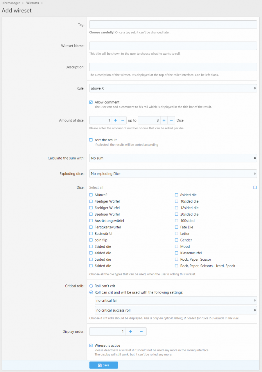

5. Create at least on Wireset
Nor, tear dice and rule together.
Tag and Title again as usual.
You can add an optional description. This is used on the help page and in the roll interface. Keep it short.
You can select now your or an importet rule and allow comments to the roll. e.g. the user can enter the skill he is rolling on.
You can enter boundaries for the amount of dice per dice. If select more than one dice and choose 1, every die will be rolled.
Select Sum and Exploding option.
Choose the dice which can be rolled in this wireset.
Finally choose crit options and save it.

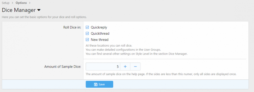

6. Check Settings
You need to allow at least one location where a roll can be performed. If you disable this for Quickthread and New Thread, the first post of a thread never will have a rolled dice in it. Maybe thats what you want.
The Sample Dice Setting is only visible in advanced mode.

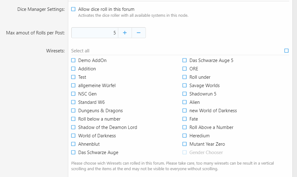

7. Forum Settings
Now, edit the node, where the users should perform their rolls.
The Max Amount of Rolls option will coming in one of the next releases. The other options should be self explaining.

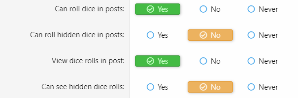

8. User Group Settings
Go and set Usergroup Settings. There are also Moderator Settings avaiable. Align them in general and/or on a per Node base.
Hint: The hidden rolls settings, are planned for the next version.

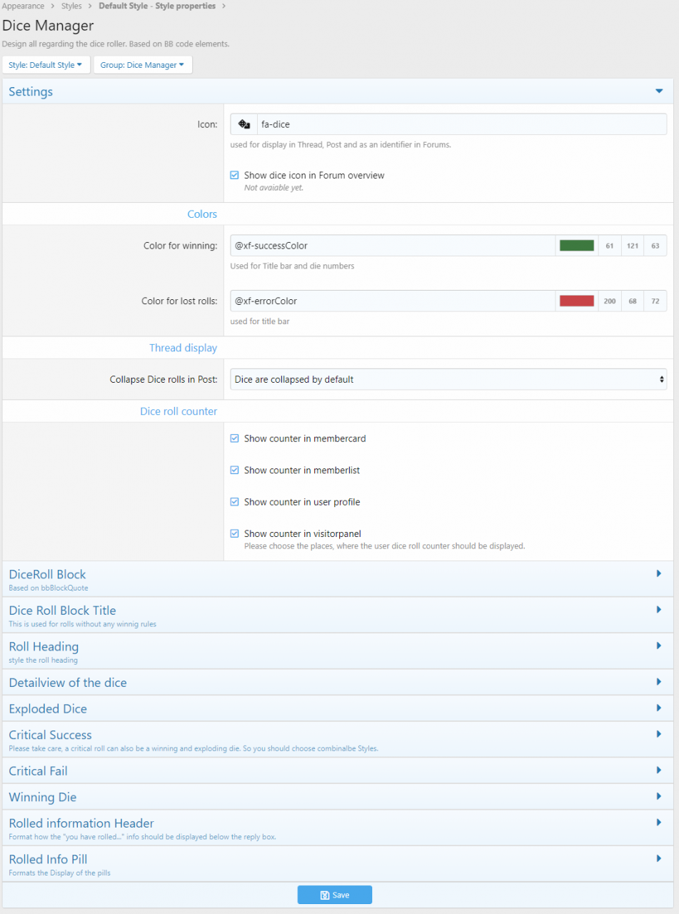

9. Align appearance
You can style many items in the Style itself to fit it to your needs.
