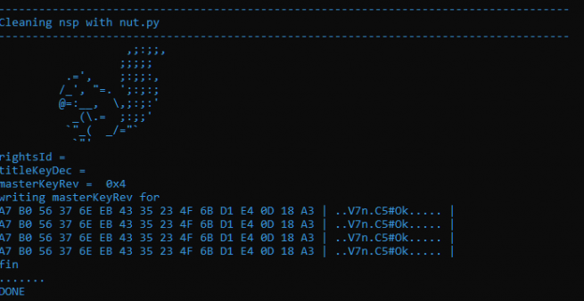

Le développeur julesontheroad vient de mettre en ligne une nouvelle version de NSC_Builder qui passe désormais en v0.75. NSC_Builder a succèdé à NUT_Batch_Cleaner, qui sert d'implémentation de son hacbuild moddé.
NSC_Builder, que l'on peut aussi appeler Nintendo Switch Cleaner and Builder, est basé sur la fonction "REMOVE_TITLE_RIGHTS", qui vous permet d'effacer le cryptage titlerights des fichiers nsp. Tinfoil et le programme d’installation SX installeront le ticket dans un sens ou l’autre. Pour que celui-ci ne reste pas dans votre système, vous devez effacer le ticket et le certificat du NSP. NSC_Builder se chargera de cela.
Les changements de cette version v0.75 sont nombreux, elle rend possible la configuration de bloc, la possibilité de changer la génération de clés, et apporte des corrections pour les RSV soient plus correctes.
v0.75- Added configuration from the bat, option to change keygeneration, corrected RSV readouts and more.
Note (v0.75. b - Corrected minimum RSV for 6.2.0
1.- Added options to change keygeneration to help run games at lower firmwares.
Note it won't always work as the game can have other dependencies than the firmware. 6.2 to 6.0 seems to work and 6.2 to 5.0 works if basegame is 5.0
2.- Added "Mode 0" - Profile configuration from the bat.
3.- Added auto-profile linking. A profile Bat will link with it's configuration file if they follow the following name scheme:
a ) Bat -> batname.bat
b ) Profile in zconfig -> batname_options.cmd
Where "batname" is a name of your choosing. You can add as many bats in the same folder as you want with different profiles this way.
4.- Corrected RequiredSystemVersion reads. It seems like our update XML read the value wrong and RSV is 4bytes long instead of 8bytes long. Thanks to Liam for the tip.
5.- Added better navigation from the bat and dissable auto-exit in manual-mode so people can see the log. (Auto-Exit can be activated in the configuration)
6.- Added "mode 5: file-info mode". Dragg a file and choose if you want to:
a) See it's content
b ) See "nut-info" (as NUT from blawar shows it)
c) See Firmware Requirements and to what is patchable without changing the keygeneration )nca files encryption)
d) Get a read of the cnmt
You only need to load the file one time to get all reads and the functions will let you print each read to a text file in "INFO" folder at bat's route.
