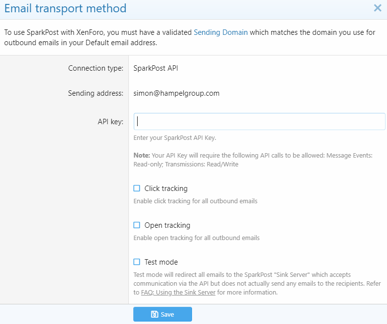

As per the screenshot above - you may configure some transport options when configuring SparkPost.
- Click Tracking turns on click tracking on all links in emails sent
- Open Tracking adds a tracking image to all emails sent to track opens
- Test Mode will append '.sink.sparkpostmail.com' to all recipient email addresses so we can test communication with SparkPost without actually sending any emails to the recipients.

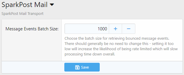

There is an additional configuration page under the SparkPost Mail option heading:
- Message Events Batch Size allows you to configure how many events the system will attempt to retrieve in each batch. In general you shouldn't need to adjust this from the default.

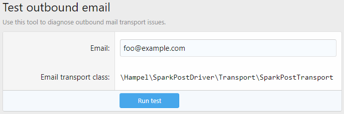

You can test the functionality of the addon using the built in XenForo email test system - go to the admin UI > Tools > Test outbound email
Note the email transport class should be \Hampel\Symfony\Mailer\SparkPost\Transport\SparkPostApiTransport - if it isn't, then you haven't installed or activated the addon correctly.

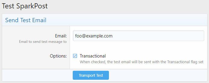

There is also a second test facility which allows you to specify whether to send transaction or non-transactional emails. Go to the admin UI > Tools > Test SparkPost
Turn on the checkbox to send transactional email - turn it off to send non-transactional.
In all cases, you should examine the headers of the emails you receive to verify that it was indeed sent via SparkPost and to validate the presence/absence of the List-Unsubscribe header (the header should be present for non-transactional emails and absent for transactional emails).
