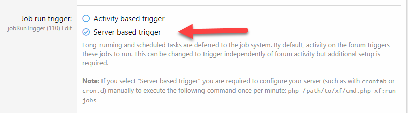

Once installed, go to the System and performance options page as change the Job run trigger setting to "Server based trigger"
