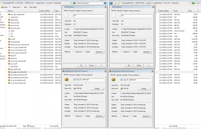

Details of 4.81 DUALBOOT FIRMWARE
Made from OFW 4.81.
ECDSA check patch applied to isoldr in lv0.
ECDSA check patch applied to spu_pkg_rvk_verifier.
Same metadata applied to keep the exact same size as OFW. (see pic below) Even all the encrypted files inside CoreOS are the same size.
Can be installed over OFW 3.55 and any CFW with a lower or same version.
While on this DB OFW 4.80, you can install any CFW with the same or higher Syscon version.
Can only play disc based games and games downloaded from PSN. (Basically it is just like OFW, except you are able to go back to CFW without a hardware flasher.)
